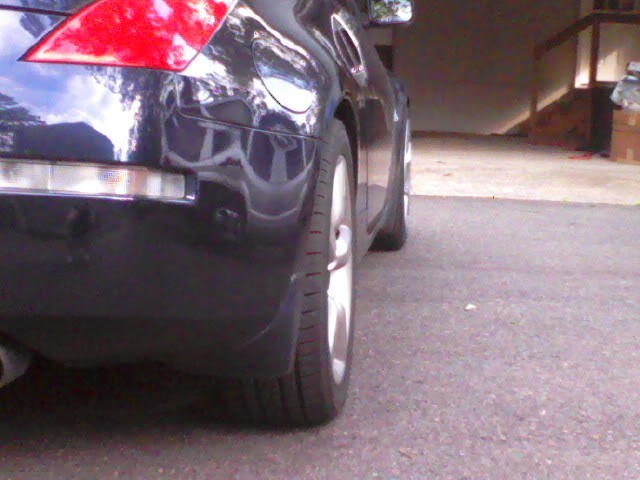

I'm about to pick up Ichiba V2's front and back. I have stock suspension and the OEM 18" wheels. I've seen a lot of pics with 20MM fronts and 25MM backs, do you think 20MM all around would look decent? I was turning away from getting anything larger than 20MM because I'm unsure if I will be dropping the car in the distant future.
Old Aug 5, 2011 | 07:57 AM
  #580
Brogan07's Avatar
Brogan07
Joined: Jun 2011
Posts: 168
From: NJ
25mm Ichiba V2's on stock susp and OEM 18" wheels.
I don't know how this would mesh with a drop, tho I'd be interested to find out.
