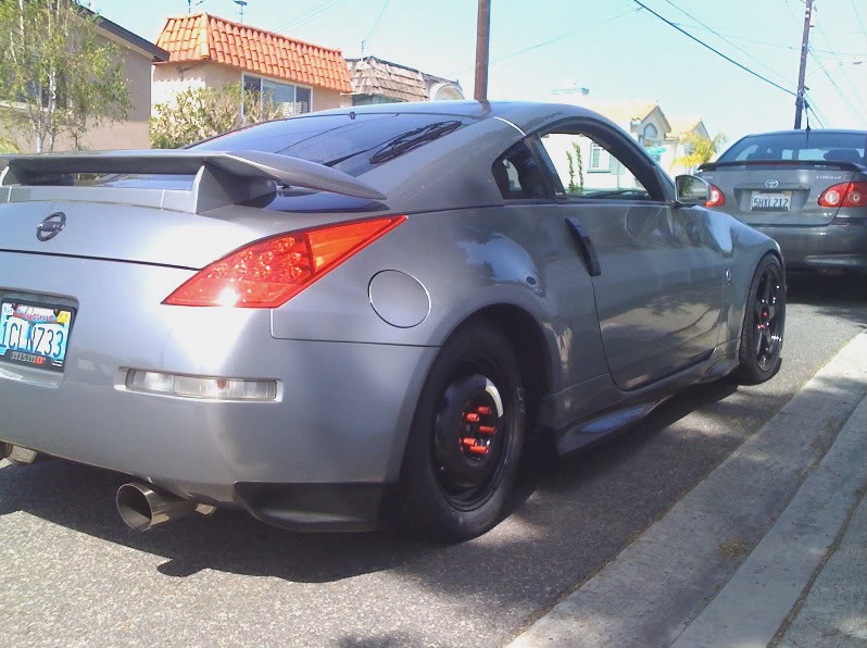

What size spacer were those? I ordered 15 and those might leave the bolts protruding. It's OK if the bolts extend on stock wheels due to *pockets* or spaces to take up any extension of the bolts. What I'm wondering is...will the SPARE TIRE make it on also, or does the spacer (if bolts extend) need to be removed for the spare?
Old Sep 20, 2011 | 01:28 PM
  #626
ronn1's Avatar
ronn1
Joined: Aug 2011
Posts: 1,374
From: Burbank, Ca
Default Spare tire and 15MM spacer question
I assume a 15mm spacer is going to leave the lug bolts extending out some (I have stock wheels so I'm ok). Ok...what about putting on the SPARE WHEEL?
Are the studs gonna hit? If so, I guess would have to remove the spacer then.
Oh..I searched on this...no dice.
Edited:
Just pulled the spare (this is new car for me)..
Looks like exposed studs on 15MM spacer will interfere with the spare. No biggy...
Just gotta pull it off.

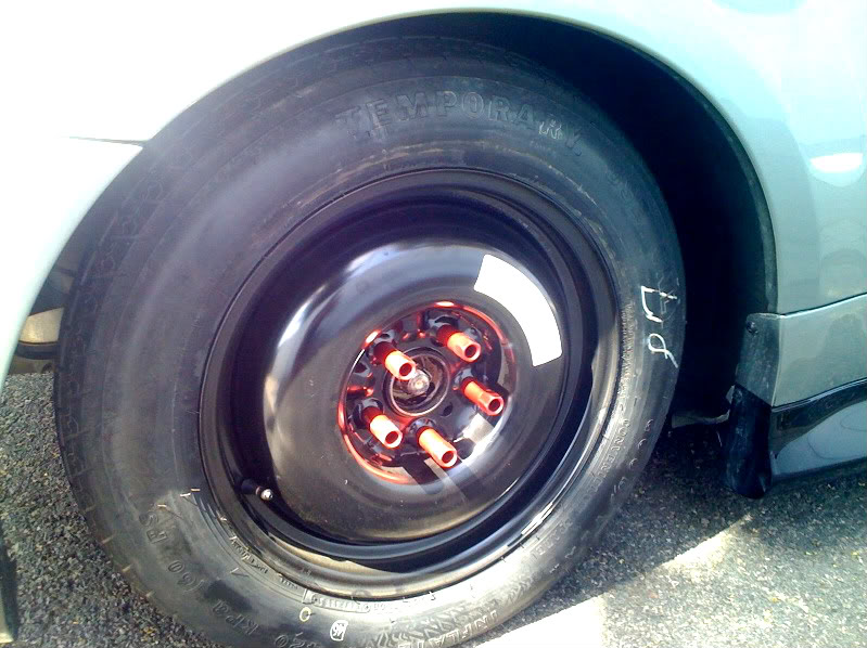

For those who have 15MM spacers or extended lugs with smaller spacers (lugs protruding beyond spacer).....
If you plan on using your spare wheel you'll need to remove the spacer!
You should plan on keeping the proper SPACER socket in your car..I think most use a 17MM thin wall socket..some use the special keyed socket.

yep, to use a spare, a spacer under 25mm thick will need to come off.....
review my post 6 and 7 for oem studs sticking PAST the surface plane of a spacer that is less than 25mm thick..

Just for reference..
20mm H&R spacer w extended studs and extended lugs on a spare:
Old Sep 23, 2011 | 01:39 PM
  #636
JasonZ-YA's Avatar
JasonZ-YA
iTrader: (60)
Posts: 11,204
Likes: 32
^ usually open ended nuts..........when using longer studs and removing the spacer...
notice how the ones in the bottom right are open ended......
-J
