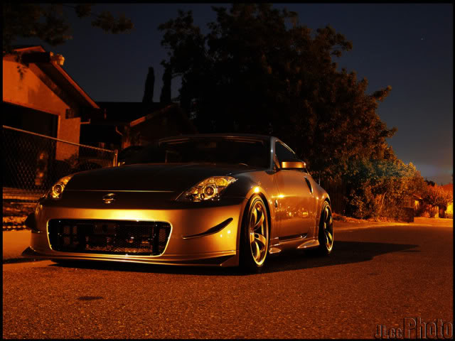

[QUOTE=Duckeee;9331146]finally got them on and lowered the car some more. sorry no rolling shots yet.
had to roll and pull all fenders to make them fit.
18x9 -1 235 40 18
19x10 -1 265 35 19
Nice Duckeee, Here's another shot of mine. New paint and new kit installed.
Running
18x9 +10 235x40x18
19x10 +5 255x35x19
