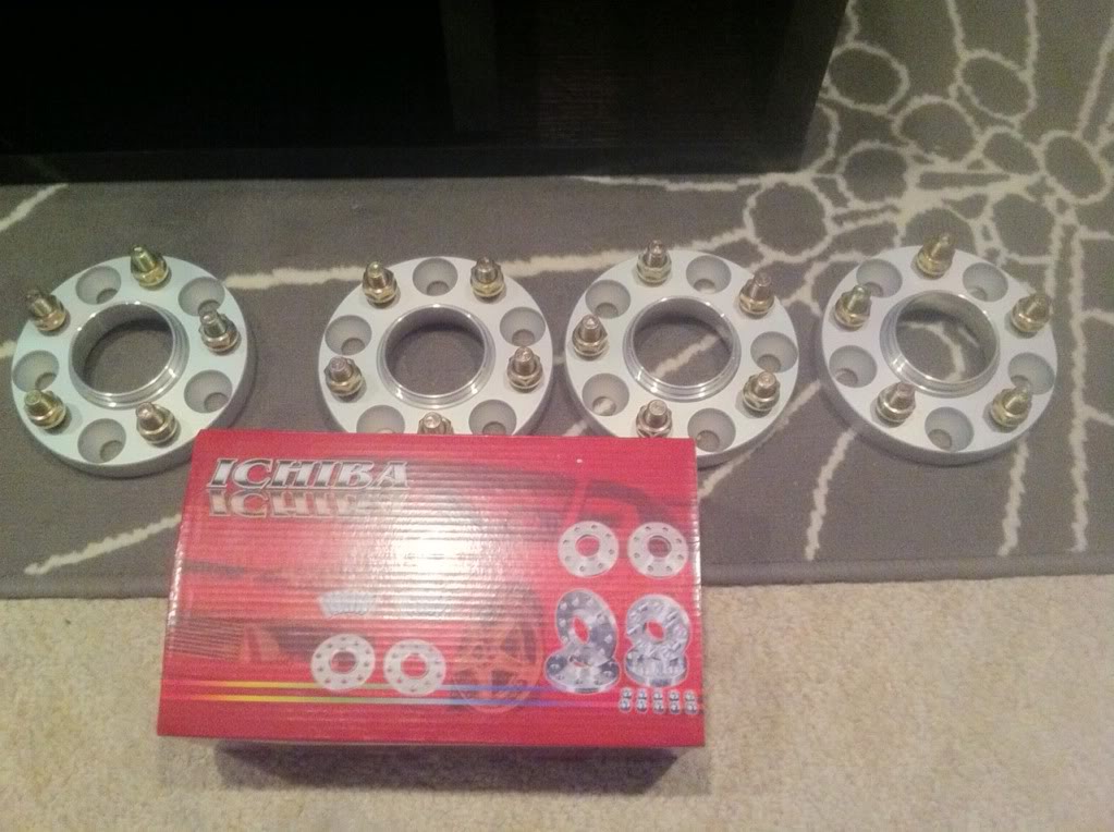

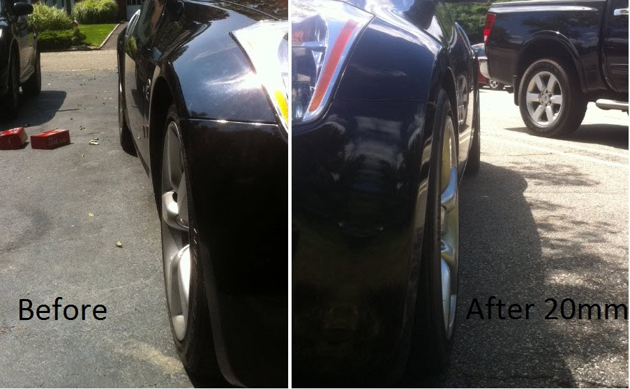

From: Roseland, NJ

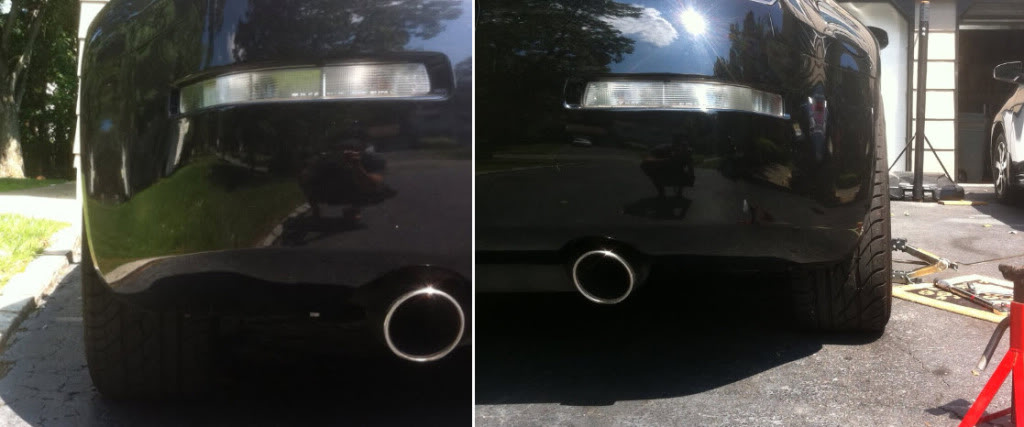

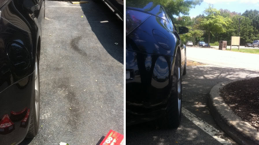

Finally got a day to install my spacers! 20MM all around, Ichiba V2 with hub rings and mounted studs. I don't think I feel any difference at all, it might feel slightly more agile and stiff when hitting bumps, but its barely noticeable at all. I haven't taken it up to high speeds yet, just about 60mph with no shudders/shakes. So far so good, hopefully they hold up. I torqued the spacers down to 85lbs, and my lugs with the normal force.

Yup, pretty much exactly the change I got with 25mm spacers, same brand.
It's just another one of those design aspects where you wanna ask, "Why wasn't it like that to begin with?"

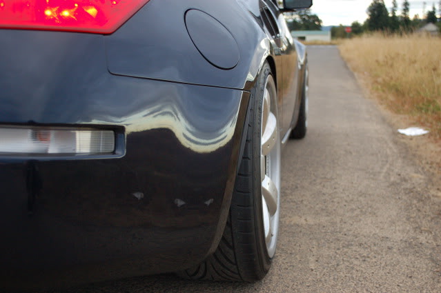

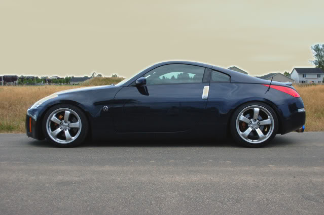

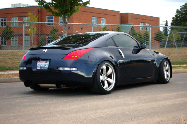

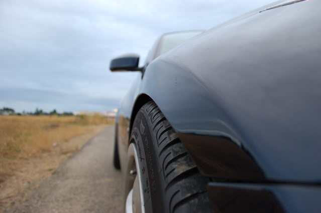

  #598
Duckeee's Avatar
Duckeee
Joined: Jan 2011
Posts: 2,724
From: Portland OR
Originally Posted by miles85916
When you get them put on i want to see pics, get a still shot and a rolling shot if you can. Thanks Duckee
finally got them on and lowered the car some more. sorry no rolling shots yet.
had to roll and pull all fenders to make them fit.
18x9 -1 235 40 18
19x10 -1 265 35 19

Posts: 168
From: NJ
Duckee, when you go over a moderate bump or tight corner, what kind of rubbing do you get, if any?
