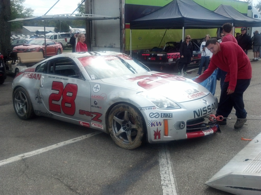

The second Z that flipped during the race over heard them some brake failure.
That is 2 Z's is one weekend with brake failure, one totaled and one repairable I think. Hard to see from the picure
That black drop top SE30 in the backround is my friend, local bayarea kid, he took 2nd place in SE30 this year.
