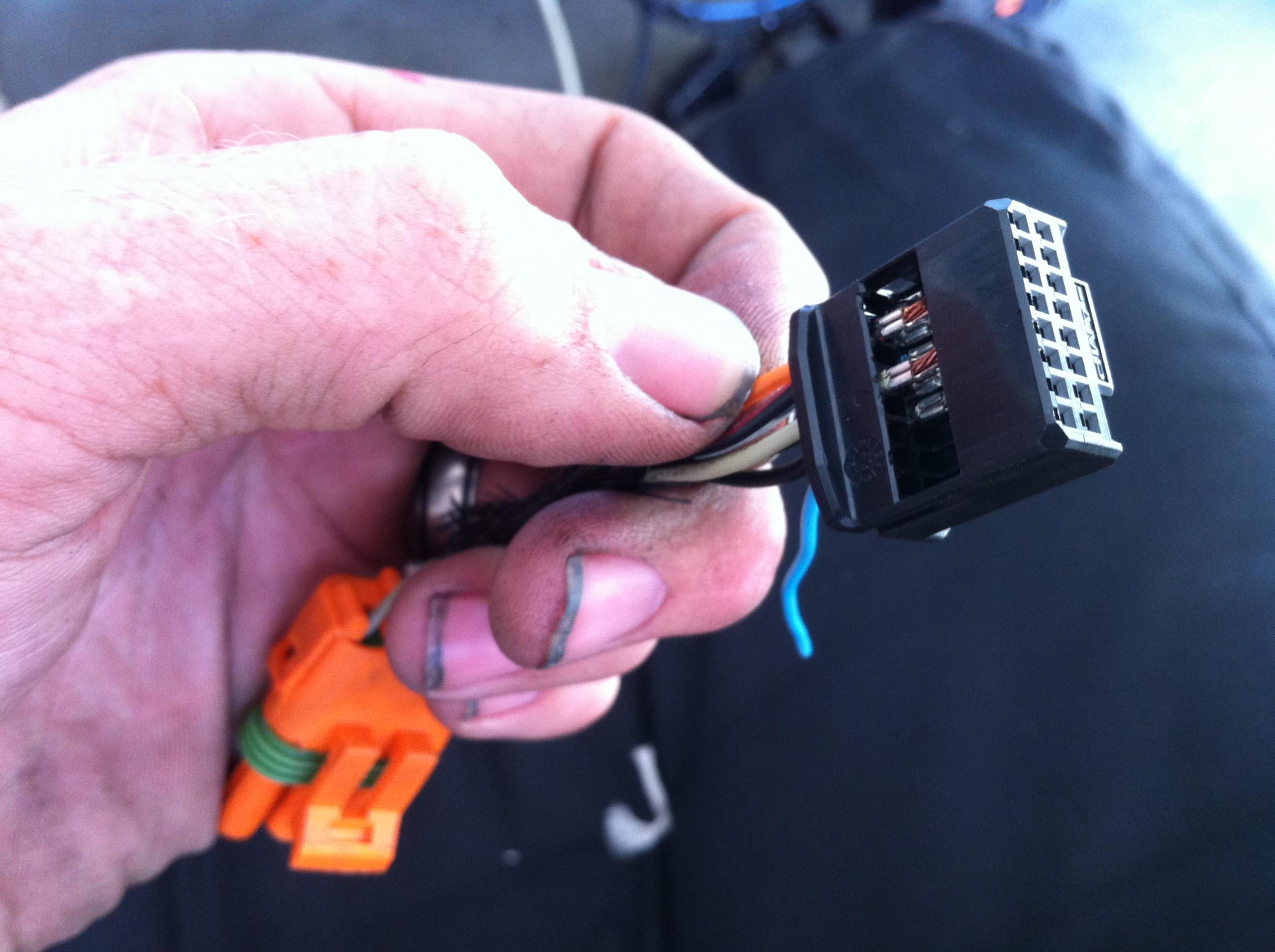

im having some trouble with my pro plug-in the connector that plugs into the Haltec for MAP, IAT, boost
control and the wide bands. The wires that are in there are wired
incorrectly, and there aren't enough wires for what we need to do.
Also, If you notice that you can "see into" the connector... It is
because it is broken and missing its locking tab.
Car has been sitting for almost 2 weeks because 1 i cant find a new connector 2 i would rewire it but its broke and need new bare pins.. PLZ someone who has a Lotta knowledge about the new unit and has installed PM ME..i need help PLZ

The 350z pro plugin comes with the connector and pins for you to make up your own harness. Well mine did anyway.
You can buy a prefabbed harness from Haltech that has all the pins pre-wired. The one I ordered was missing the a DPI and 12v feeds as there were 2 versions of the inputs for the aux harness. Haltech sent out the additional wires for me.
http://www.haltech.com/store/index.p...y-harness.html

We offer two solutions:
1. Plugs & Pins (unpopulated, requires crimp and wiring to your desire)
2. Auxiliary Harness (populated with wires, just connect as you wish)
Call or email to order.

Thx a lot Hal... I talk to Dustin earlier today and placed an order he said he would stop by haltech today n pick me one up n ship it out asap to my tuner's.. THX you guys ROCK!!
