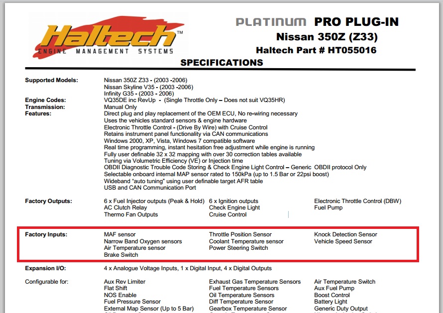

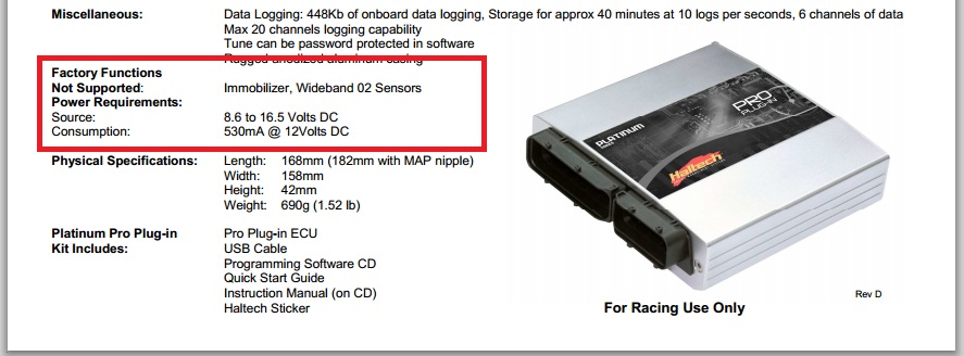

With this, do you need to put in new widebands or will it work with the factory O2 sensors (G35 2005 revup, which has factory widebands I think)

since it controls the canbus i would assume it could read any can inputs which would be the widebands. For an NA application that might be ok but i would never tune off of the oem widebands. The ones i've looked through on cipher only go down to 11.25 and were quite a bit off compared to my innovate LM-2 and the calibrated dyno widebands used to tune those vehicles.

Don't quote me but looking through the software I believe it only supports the factory narrow bands. Widebands are supported but through the AVI inputs.

Not planning on tuning it through the factory widebands, but I am interested in if I need to get two new aftermarket widebands to use with it for normal driving, or if it will work with the factory ones.

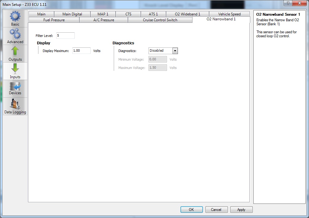

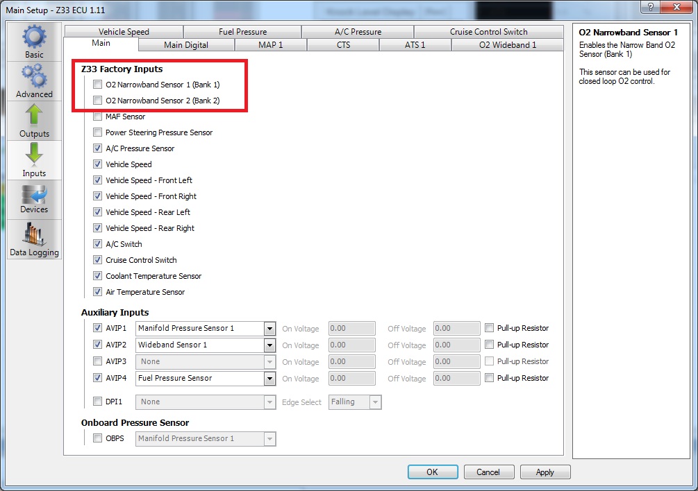

Below are the screen shots from the software. As you can see it states Narrowband inputs. When you go to the config tab of the NB sensor it does not allow you to set the scaling so I would assume it is pre-configured for 0-1v.
Unless it is somewhere else or does something funky like u say I have no idea. I would hope you could otherwise you are effectively wasting 2 AVI inputs.
Actually I just looked into the specs chart which is attached and it clearly states that the OEM WB's are not supported.

What he is asking is if it will use the oem sensors to run fuel corrections. The answer to that is yes. I'm not sure if it converts it to narrow band (don't think it does) or what but all the people running 04.5 can use oem sensors for fuel corrections which means the haltech is reading those widebands. I doubt it will display it as a wideband if you try to log it though so i think that might be where the instructions are saying the factory wideband are not supported.
If it didn't accept factory sensors then nobody after 04.5 could use a haltech without buying dual widebands and I know there are people running them without dual widebands and using factory fuel corrections.
