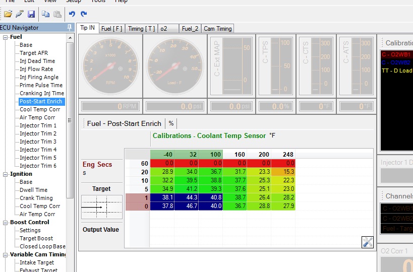

I have the new version of the Haltech on my JWT TT G35. Works great, but now that the weather is getting cold, when I leave it outside all day, and try to start it at the end of the day, it doesn't start or dies immediately on the first try. the second try it starts right up.
Any ideas on what to change to solve this (I know, not much to go on)

If it doesn't start then prime pulse time in the cold sections. If it starts and dies then you need to work on the early time cells in the post start enrichment at the cold temps.
Unless you hot wire your widebands to stay on during cranking you will just have to play with it. Hook the haltech up and turn the key on then look at the prime pulse map to see where the cursor is. Then try to start it. If it doesn't start then add some fuel to that cell and try again. I would adjust the cells around it as well. If adding fuel didn't help then try pulling fuel. Trial and error is the best way to find out if you do'nt have widebands on during cranking. Usually in cold it's too lean and in the hot it is too rich so adjust accordingly.
Increasing the prime pulse got it able to start at cold temps. Now, it is staring fine, and dying about 5 seconds later. And then starting right back up when I turn the key again, no problems.
So, which way should I be moving the timing in the early time cells, post start enrichment? Advancing, or retarding?
Thanks for the help

Dave, What I believe Jeff is saying is increase the fueling in the Fuel > Post Start Enrich table. This table is CTS vs Engine Running Time. Work on the 0-2 second column at the desired temp.
I think you took "time" literally as timing
Thanks for the help
Dave, I would keep working with fuel for the time being. Engine timing is probably ok and the last thing I adjust to help hard starting issues.
As I have selected in blue here. It's in the Post-start enrichment table. Raise the fuel in the 0, 1, and maybe even 5 second areas of the cold temps. Those will help keep it running after it gets the first cylinder fire.
If you know the temp you are going to be at the most (say if you are mostly at 60* and not down at 30* like the map shows) then you can hit F3 while you are within that post start enrichment map and add another line in there so you can adjust 60* individually.
Hope that helps. Feel free to email me directly if you have questions and don't want to wait for a response on here.
Attached Thumbnails Dynosty: Haltech 350Z Pro Plug-In - OEM ECU Replacement-post_start.jpg

Ah, yes, I did think you meant timing. Duh. Anyways, thanks for the tips, I will try some more with it, and see how it goes. It's kind of annoying, working on 'cold start' because you can only test each adjustment once a day or so, before waiting until the next day after everything cools off to try again

Quick update: managed to massage the post start enrichment and the first pulse prime and things are good now. Thanks for the help.
