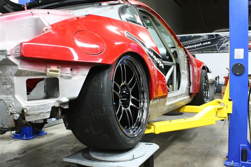

Duro78,
Sorry, but DAVIDV is right.......measure and there you go...
mimic a bump.....get your car, jack it up, jack up the tire and mimic a bump and measure!!
this guy did it with a lift and lowering the car onto something to look for bump steer, but you can do the same to see "if" you are gonna hit the fender lip.
MEASURE PEOPLE!!!

Duro78,
This guy did it with a lift and lowering the car onto something to look for bump steer, but you can do the same to see "if" you are gonna hit the fender lip.
MEASURE PEOPLE!!!
-J
*source thread for the pic - https://my350z.com/forum/autocross-r...verything.html
[B]This guy did it with a lift and lowering the car onto something to look for bump steer, but you can do the same to see
DING DING DING* That's what I did...
Just drive on a few 2x4 pieces of wood and your car should compress enough where you can see how much space you need.
Oh..BTW: "This guy" also has a full article in this month's Modified mag sharing his SCCA adventures.
