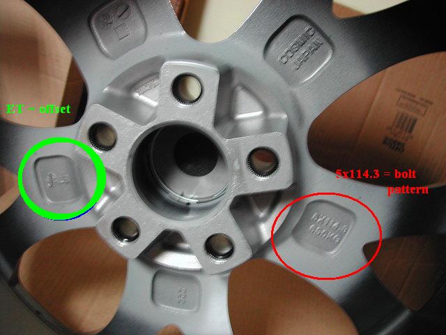

Okay, to find the offset, jack up the car and turn the wheels and get the offset of the front wheels and the back wheels....... it will most likely be stamped on one of the spokes of the wheel......get a flashlight.
Also.......did you mount the wheels on your car and measure??? measure in inches and convert to milimeters and order accordingly...........
if you get the offsets, me or anyone else can "guess" an thickness of spacer that "WE" think will look good, but in the end if you buy some...um lets say 20mm spacers and you think it needs a wee bit more..........you will end up selling and buying 25mm spacers........etc.............it is what it is...
-J

Found all the information, What sizes spacers do you guys think? Also what brand do you recommend and which type of spacer?
I have 20''x8.5 & 20''x10 TSW Thruxton wheels on a 2003 350z.
Stock Suspension, Plan to eventually get get coil overs,
Tire Size:245/35 ZR20 95W Front
275/35 ZR20 98W Rear
Offset 20 Front, 25 Rear
