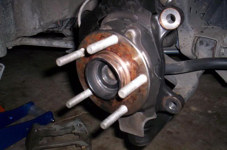

Theres an area where one stud is available once you take the caliper bracket off.
I use this guy to press it in W/ OUT having to take off the whole hub. Its easy and it works.

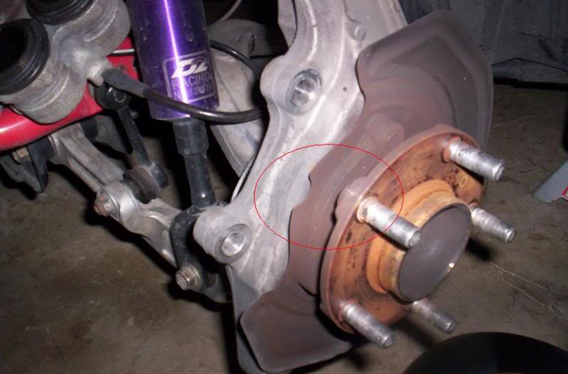

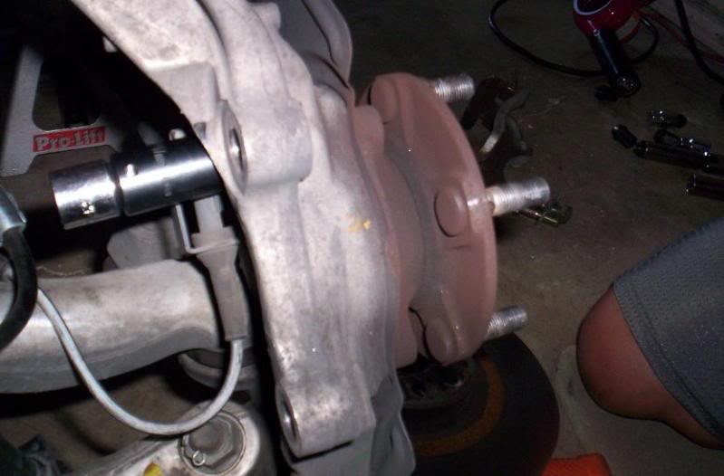

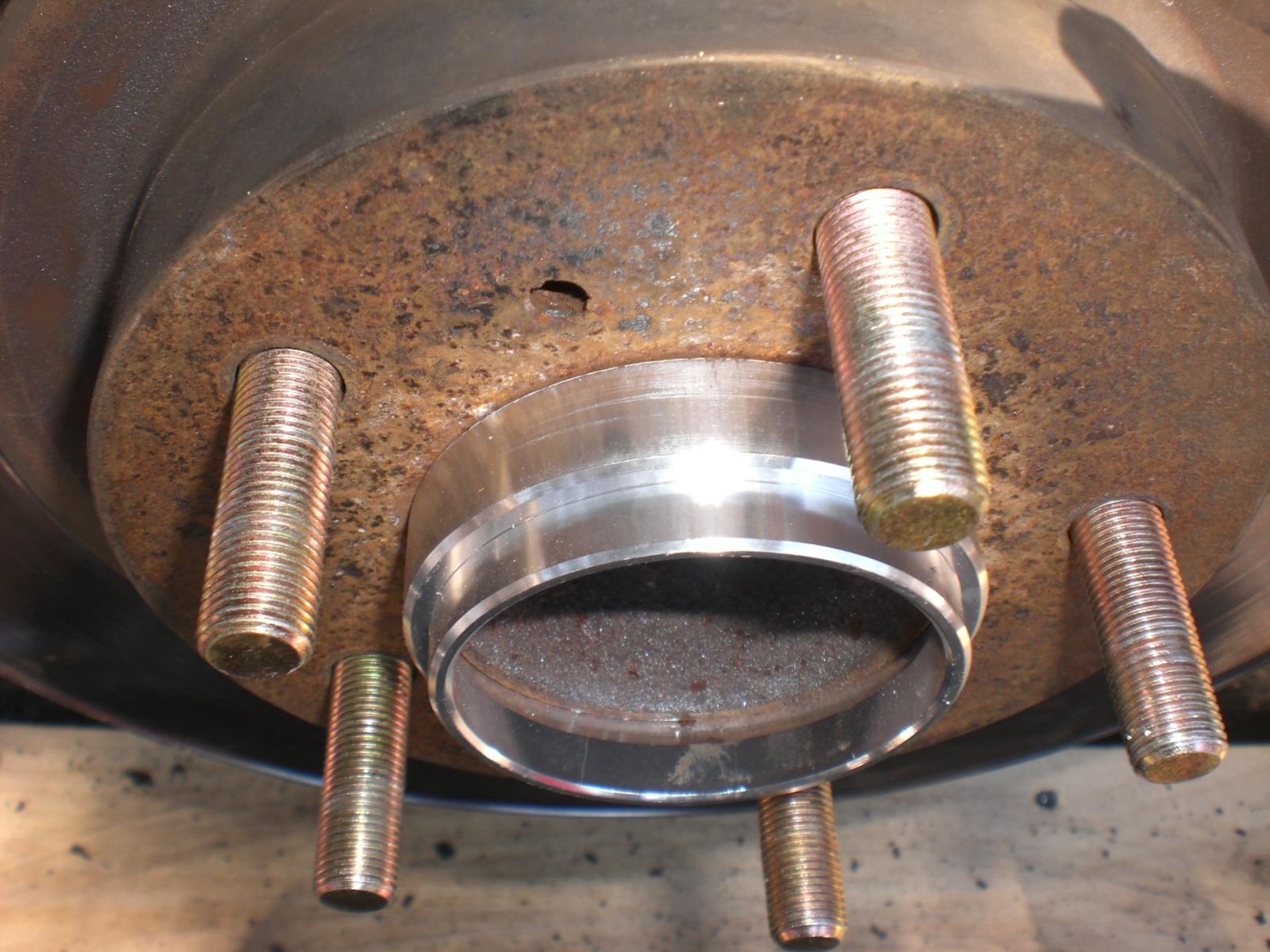

I just took these now to help...I hope it helps ya some....

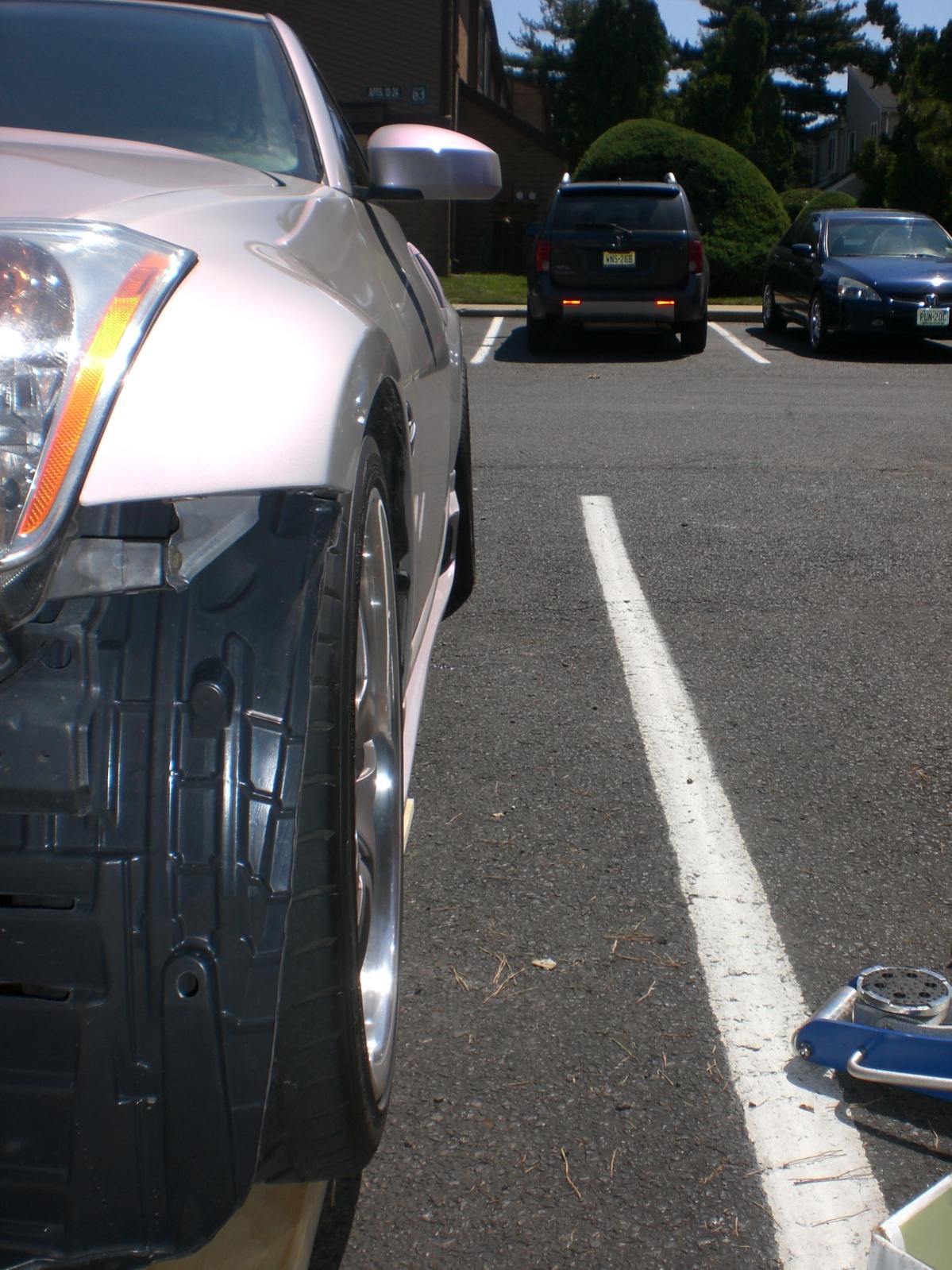

It's ok. I wasnt including the conical seat and the hubcentric ring was not seated all the way on the hub. The lugs went on fine. Should the rings have to be seated with a rubber mallet or should they just slide right on?
One of my Ti lugs stripped. At least I know the studs are damn strong to eat a lug. Starting on the second one now.

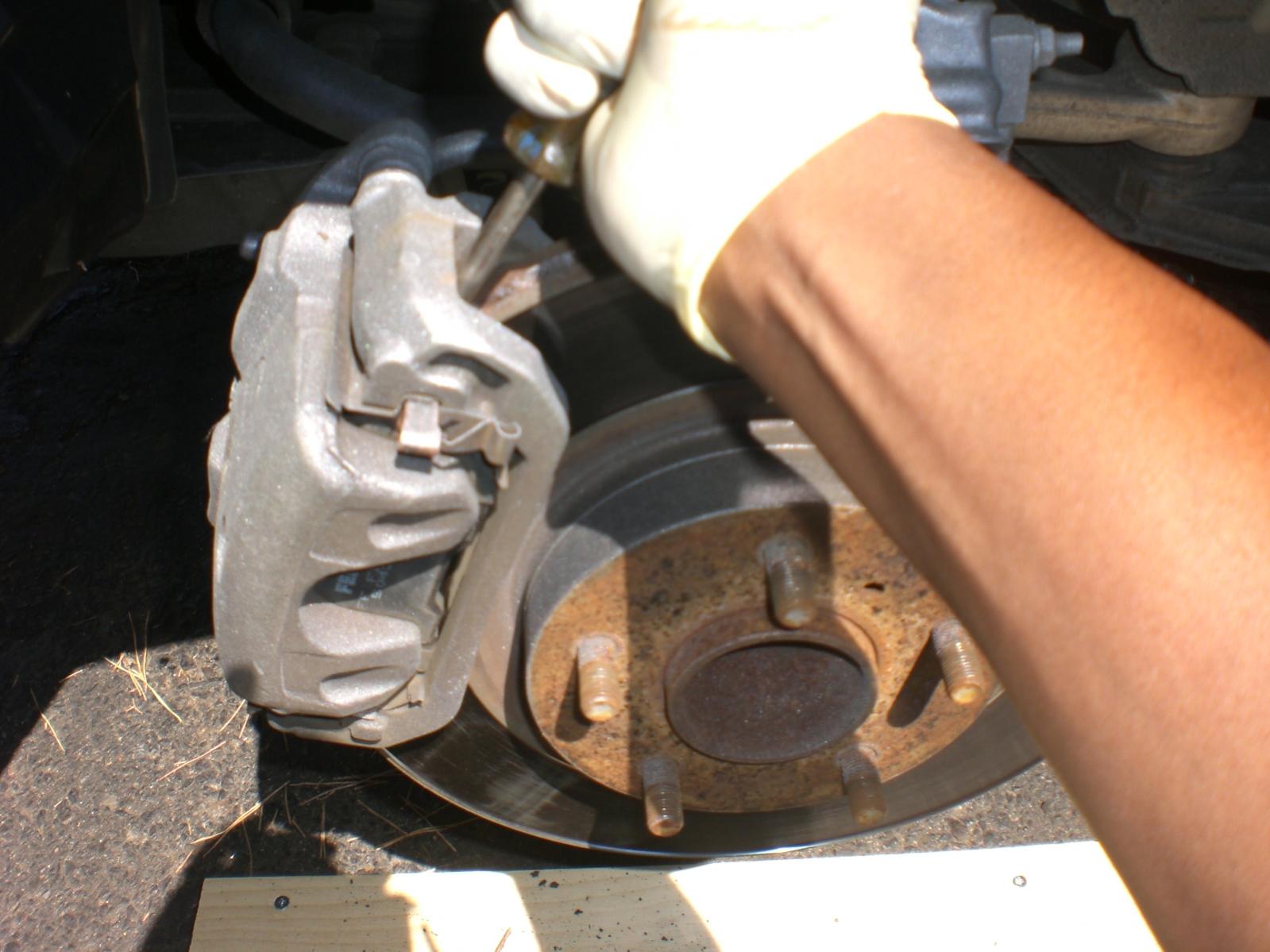

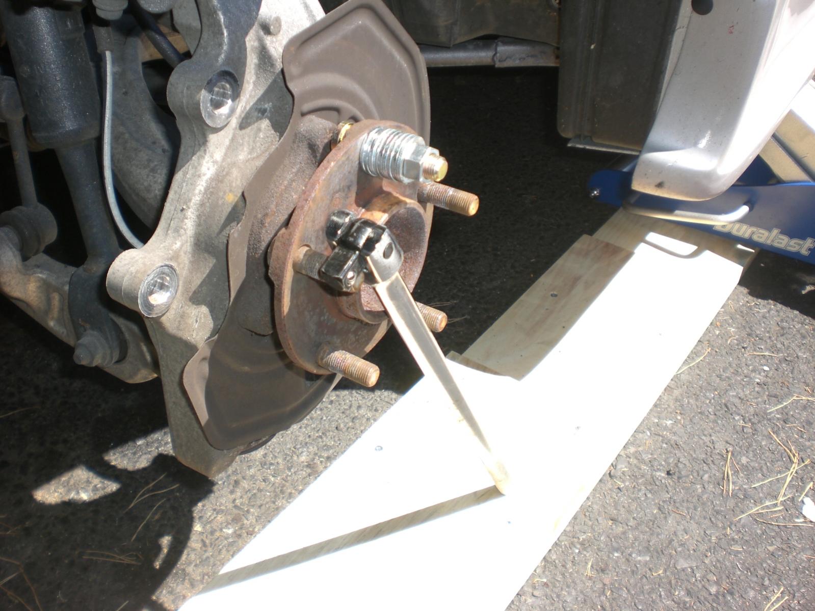

You can use a strong flathead to pop the caliper bracket off. NO need to lift the caliper.

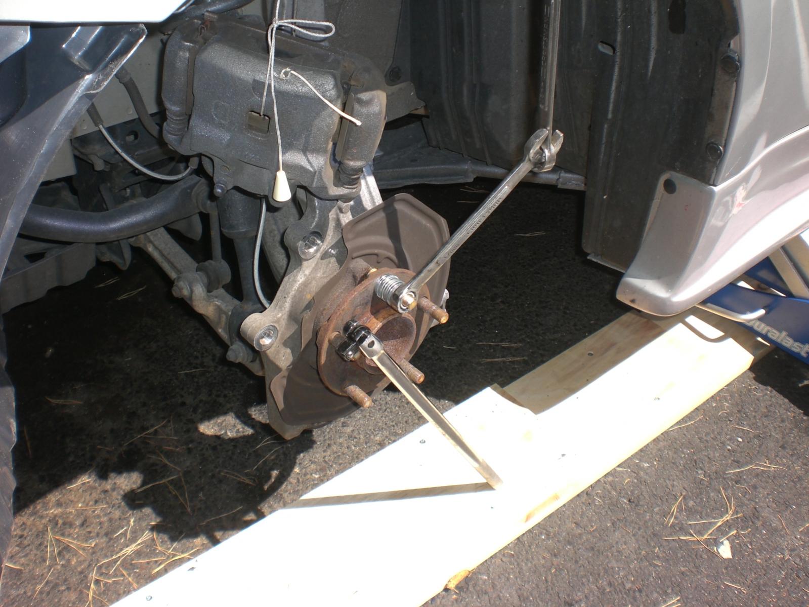

My ghetto rigged stud install. TAKE YOUR TIME. Use as many ashers as possible because it is less elbow grease and they act as a heatsink for the stud. Do a couple turns, wait 30 seconds, do a couple more. You don't want to heatsoak the bolt and have it snap. Check it with your finger to see how hot it is getting. This is the hardest part about the install.
I had to take my front bumper off to break the caliper bracket bolts with my breaker bar. THere is not way I could (and I'm strong as an ox ) break them loose in the confined space with the bumper on. It's cool though, because I need to install my grills in my INGS+1 bumper.
Overall, it's not bad at all. Just a lot of elbow grease the way I did it.
Difficulty: 3/10
Thanks for all the help and PMs!
-phreak

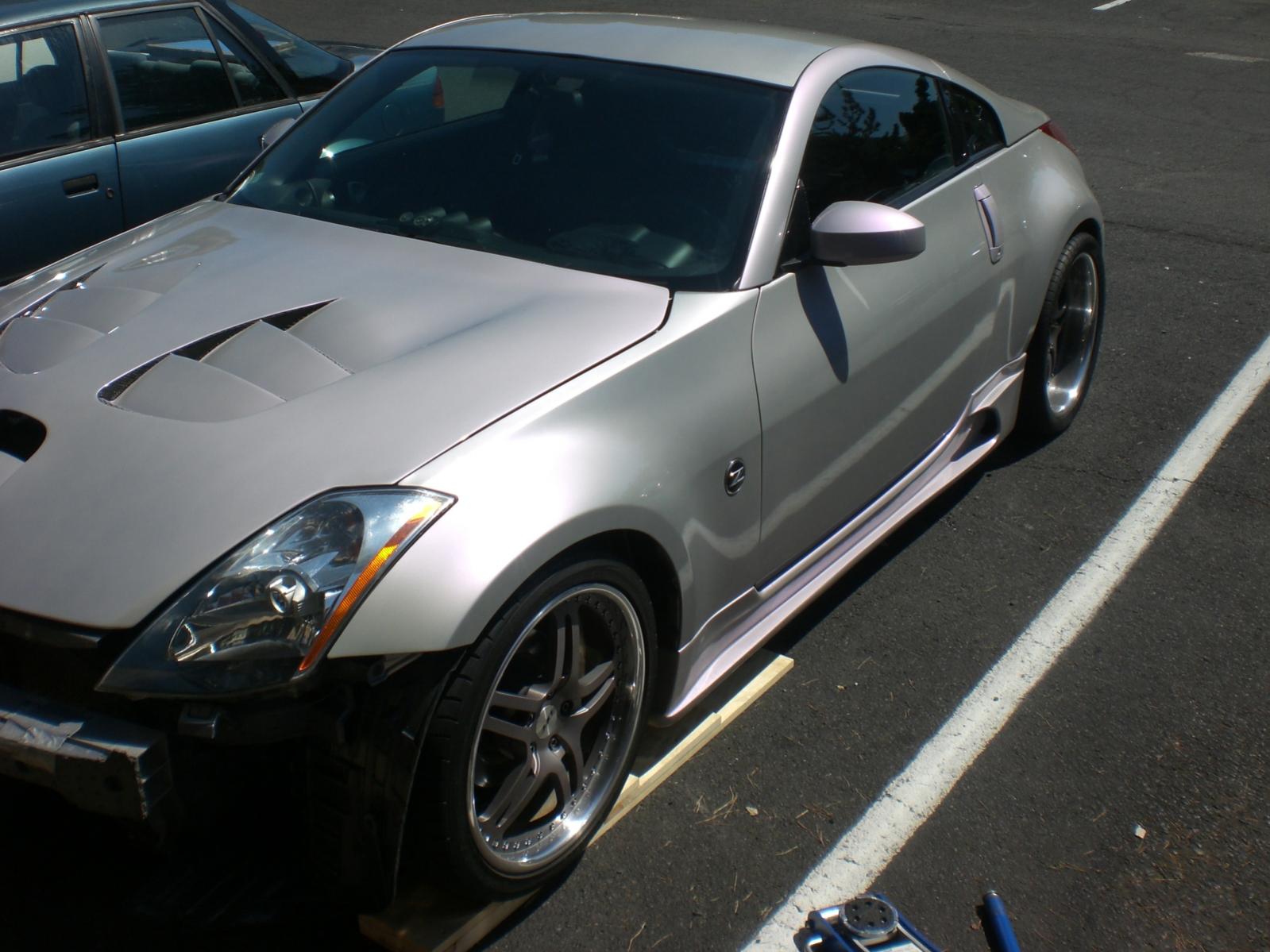

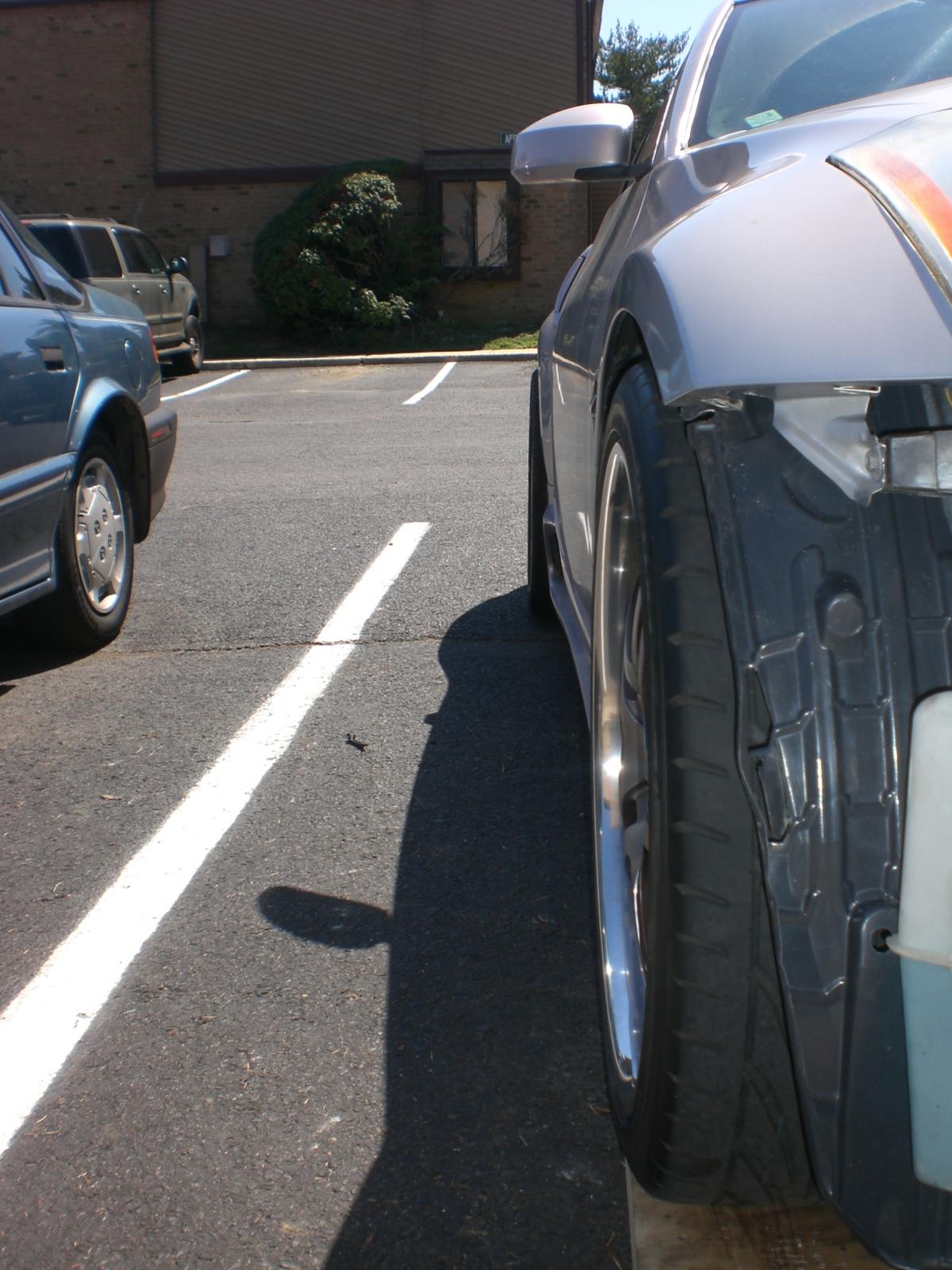

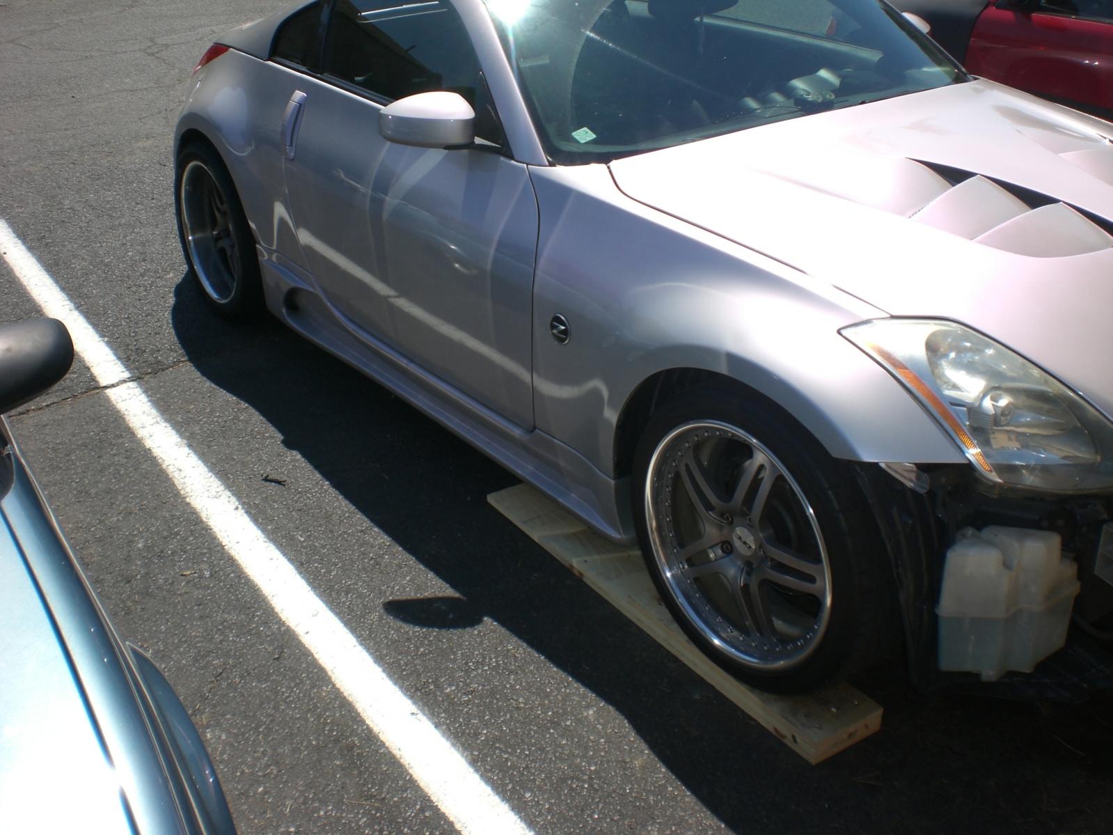

Attached Thumbnails FAQ: Official wheel "SPACER" thread!-cimg4157.jpg   FAQ: Official wheel "SPACER" thread!-cimg4160.jpg   FAQ: Official wheel "SPACER" thread!-cimg4161.jpg   FAQ: Official wheel "SPACER" thread!-cimg4163.jpg   FAQ: Official wheel "SPACER" thread!-cimg4164.jpg
Old Aug 28, 2010 | 11:12 AM
  #432
phreaktor's Avatar
phreaktor
Design Engineer
Posts: 28,233
Likes: 33
From: The Marketplace

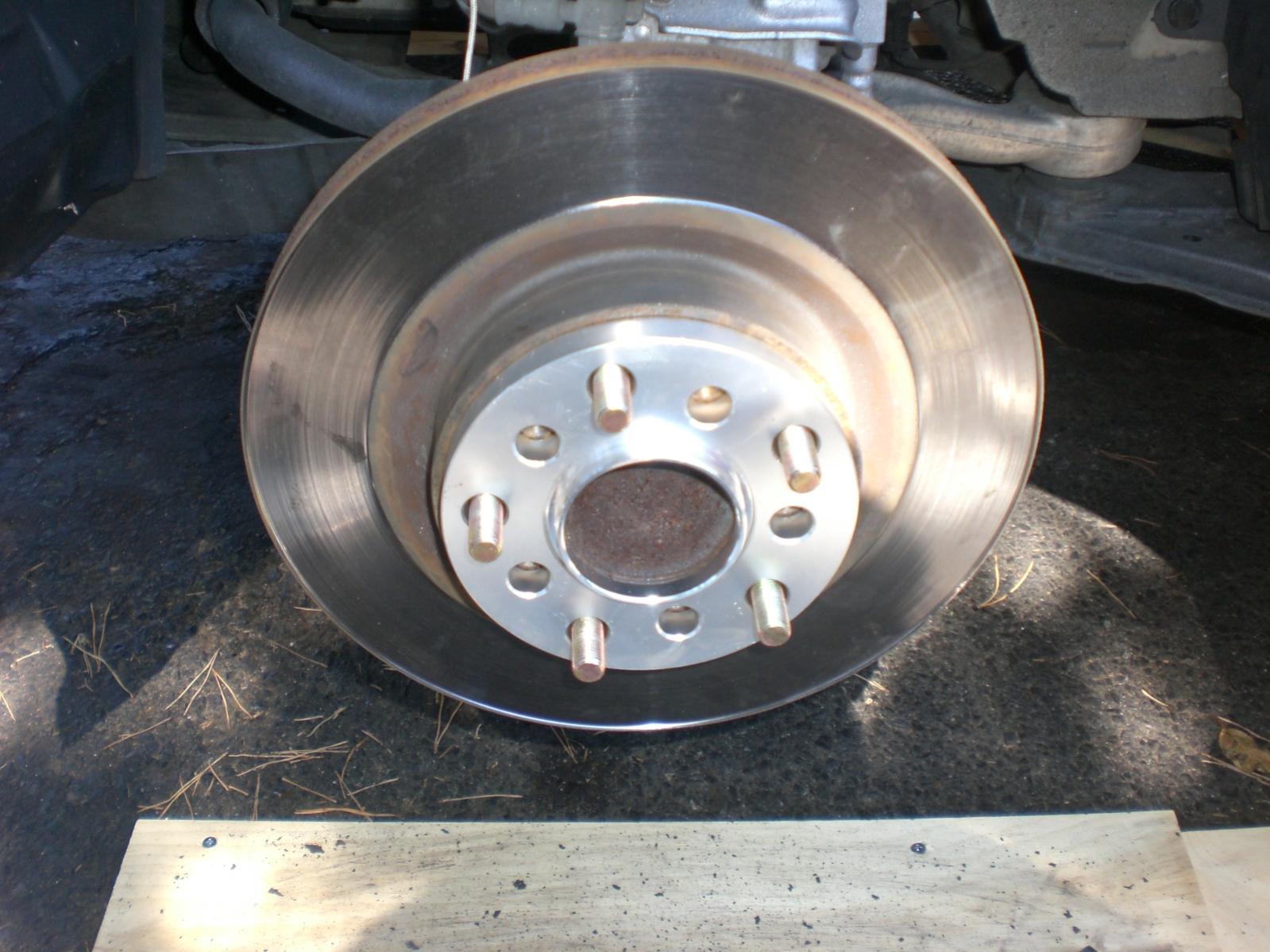

Passenger side after/Driver side before...
Attached Thumbnails FAQ: Official wheel "SPACER" thread!-cimg4153.jpg   FAQ: Official wheel "SPACER" thread!-cimg4155.jpg   FAQ: Official wheel "SPACER" thread!-cimg4154.jpg   FAQ: Official wheel "SPACER" thread!-cimg4156.jpg

instead of removing the bumper, just jack the front of the car up high enough to get to the bolts and have room to swing from the bottom..
-J

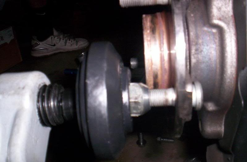

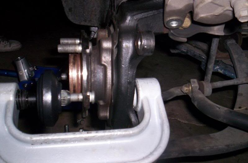

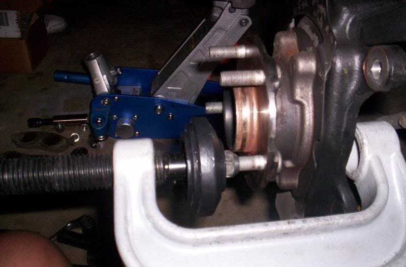

Thumbs up Another way of removing studs - I used a BALL JOINT tool
Whole process took about 20 mins per side. Pressing out the stud IMO is safer on the hub.
Use a open ended regular lug (in reverse) and leave it at the top of the stud

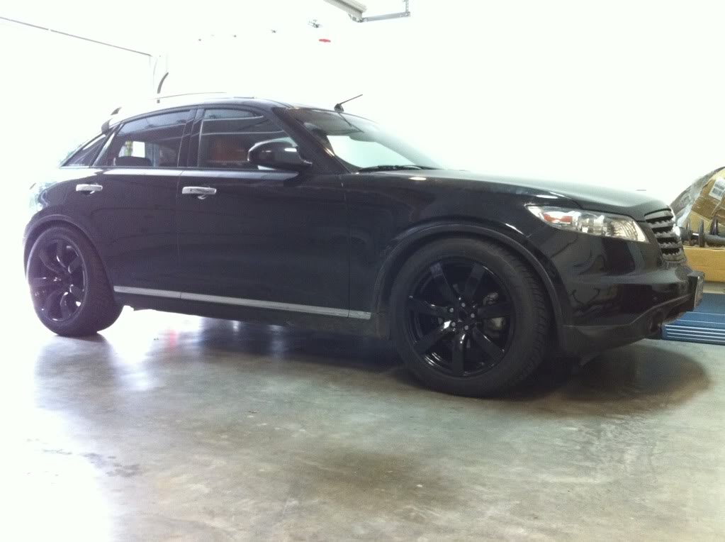

DONE - with longer studs to put spacer in the front (this is on a FX35 with GTR rims)
Got pics up?

sure - so you DONT press on the stud itself and ruin threads..
Pic per your request -
