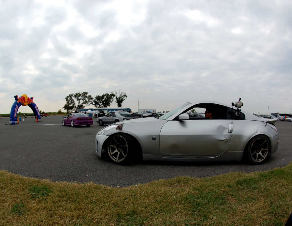

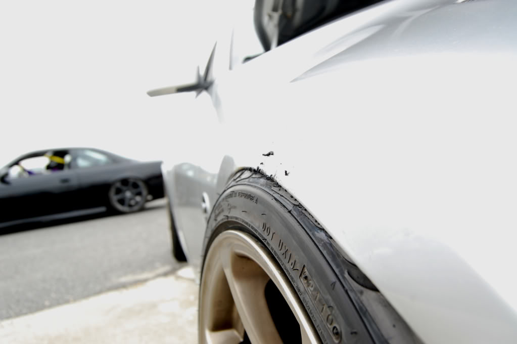

Old Nov 1, 2010 | 10:26 AM
  #473
KTran's Avatar
KTran
Joined: Jul 2009
Posts: 352
From: at home
my drift setup:
18/17x9.5 +15 cs-t zero1
ebay and project kics 30mm spacers all around,
effectively 18/17x9.5 -15
235/35/18 federal ss595rs
245/40/17 " "ss595

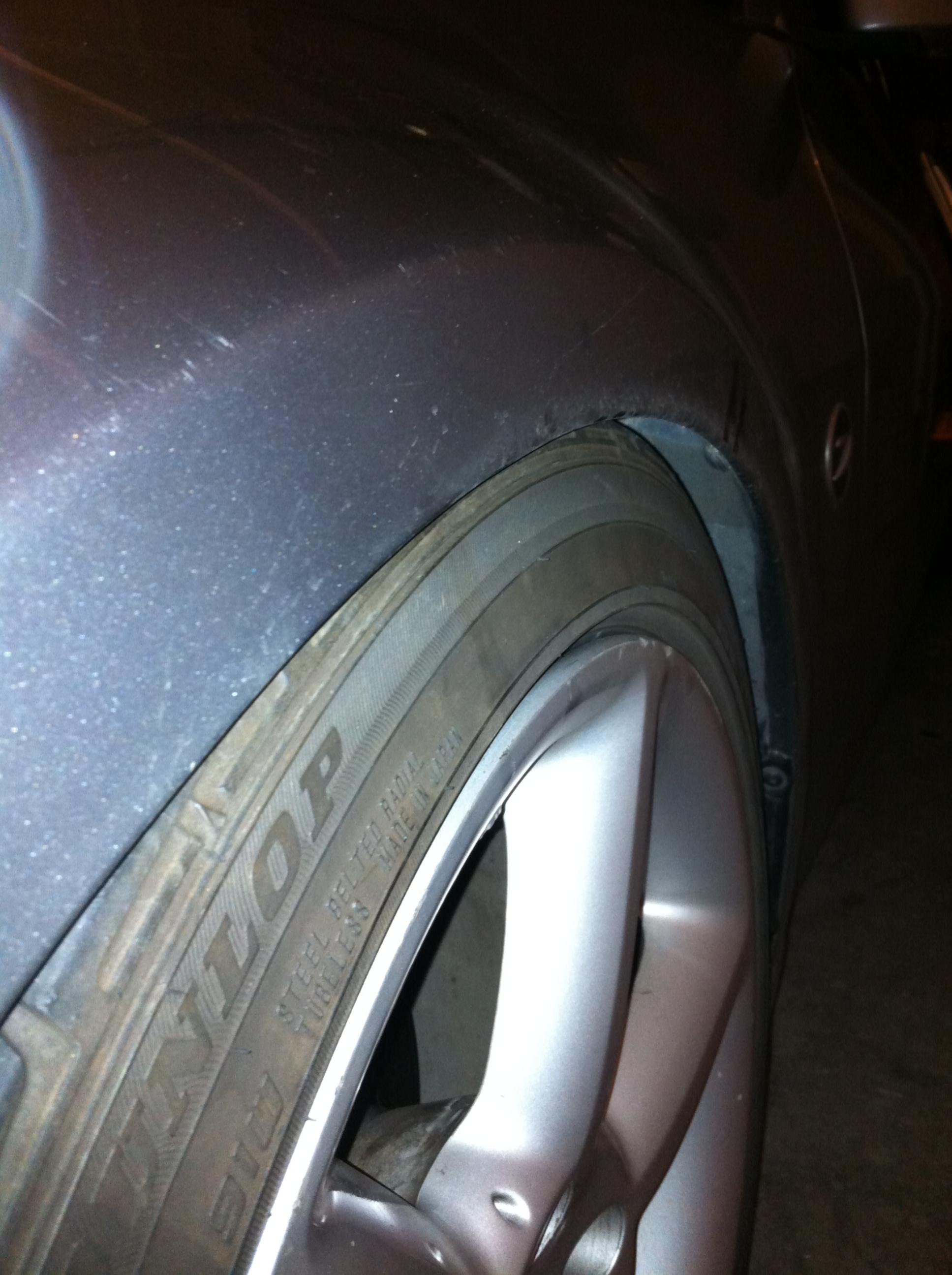

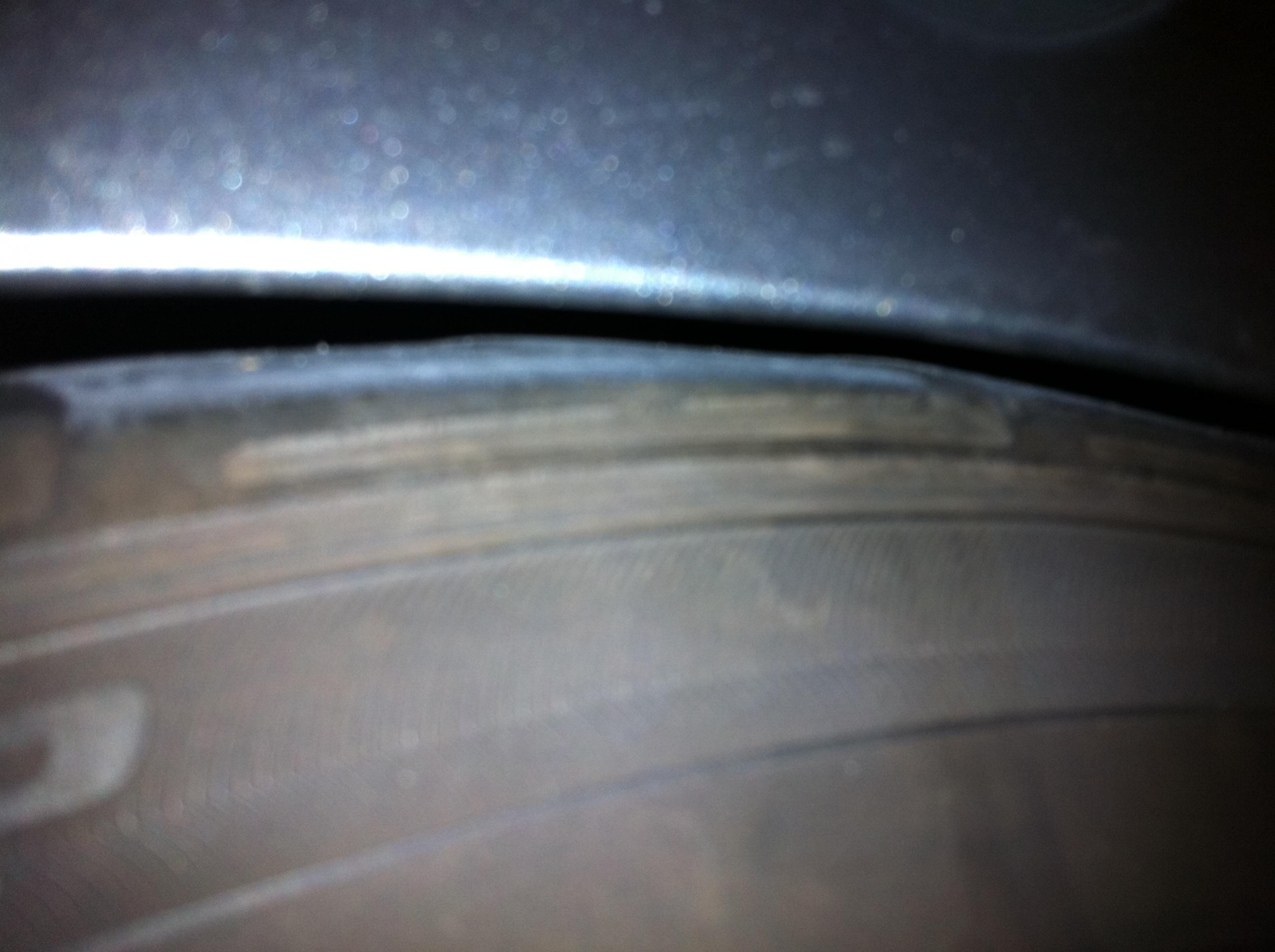

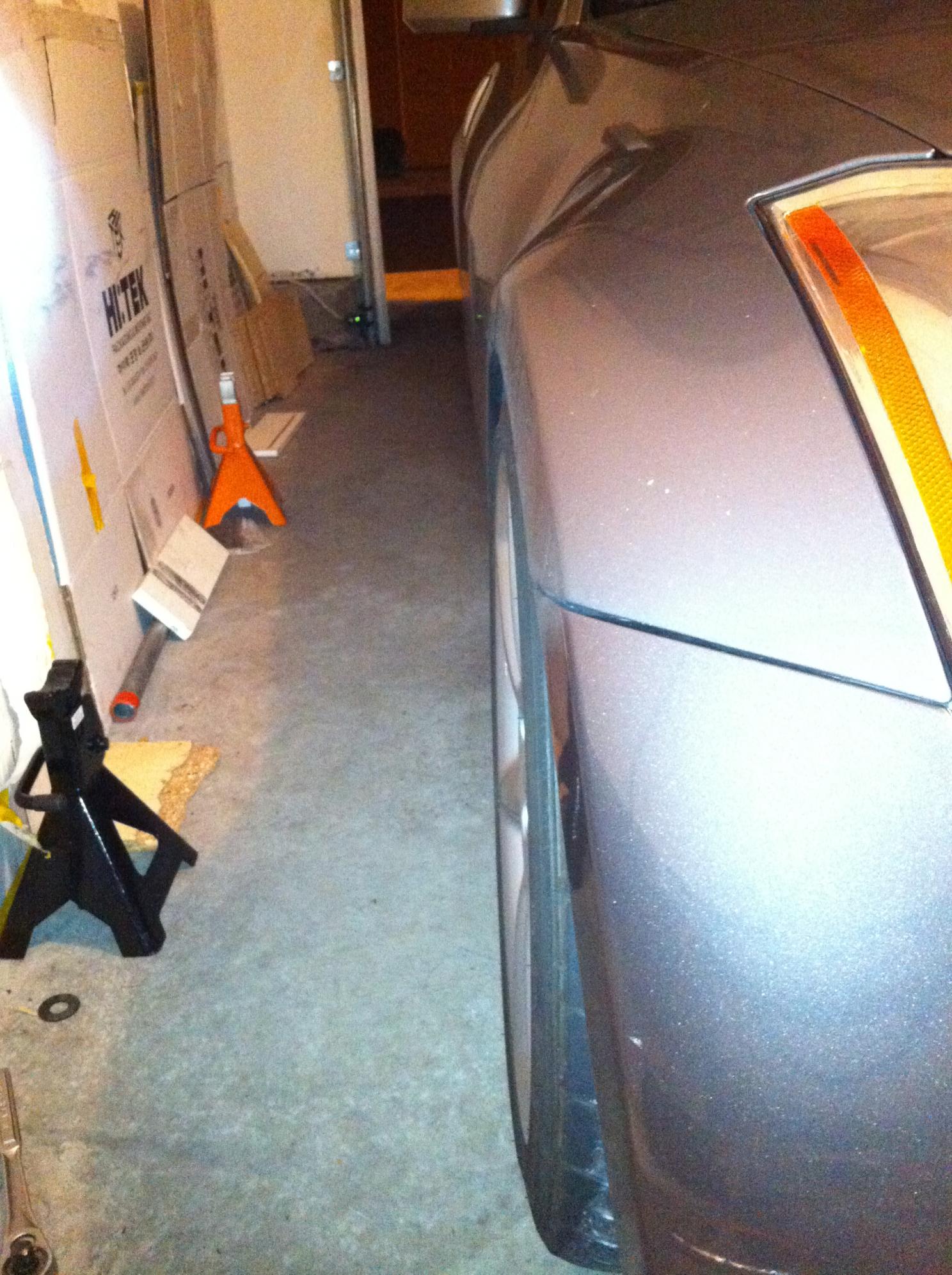

Old Dec 23, 2010 | 11:32 PM
  #478
JDMStanced's Avatar
JDMStanced
Joined: May 2010
Posts: 3,011
From: Deep in Michigan
here's my drop with 25mm spacers on. The tires are reaalllyy close to the fenders
Attached Thumbnails FAQ: Official wheel "SPACER" thread!-img_0703.jpg   FAQ: Official wheel "SPACER" thread!-img_0701.jpg   FAQ: Official wheel "SPACER" thread!-img_0702.jpg
