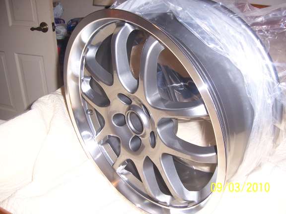

Has anyone used 25mm Spacers on a 2004 Roadster with 18 inch G35 oem Rims?
the offset of those wheels is the same as the Z wheels........i say 20mm front, 25mm rear....
other than that, mount then measure..
-J

Where is a good place to get spacers without the hub centric, long story.... the G35 Oem Rims dont fit over my hub centric....
