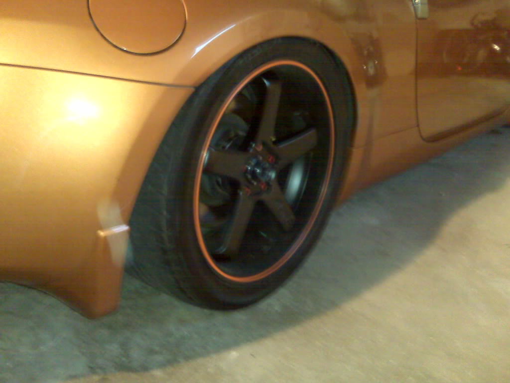

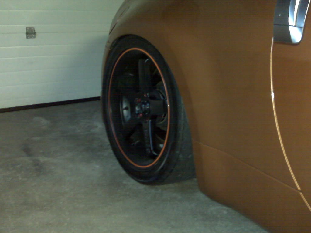

Here are the pics I promised last week:
19x9.5 +10 w/ spacer, 285/35/19. Fender roll and slight pull. -3* camber
